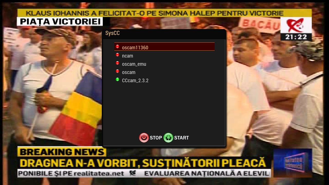

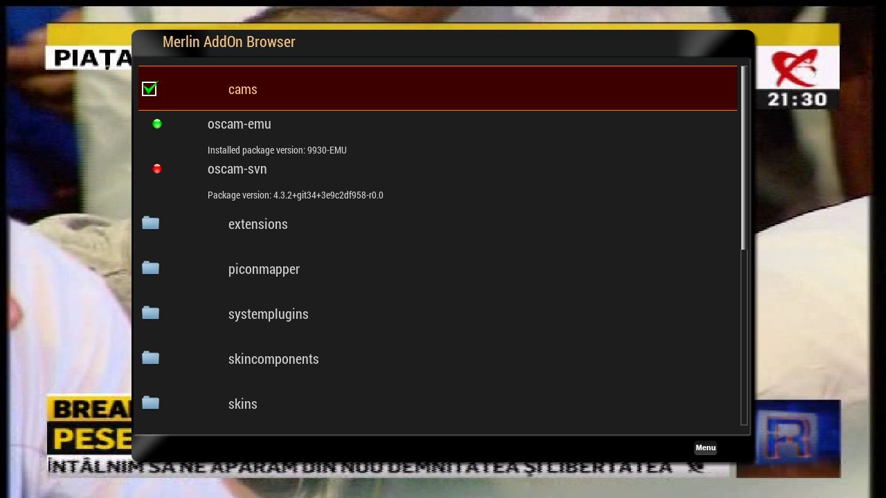

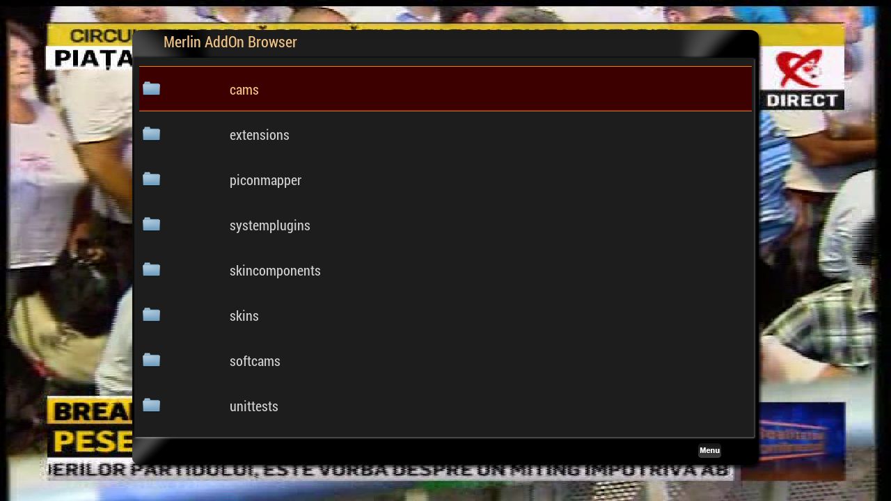

    copiere in tmp si instal....Cccam 2.3.2
    http://www.girlshare.ro/3490130949.8

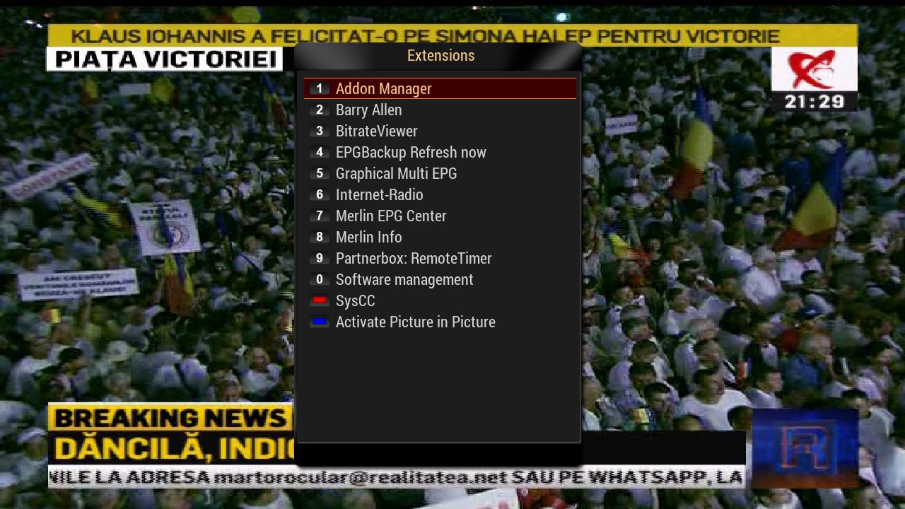

    sau....addon manager.....cams
      tspanel_8.0 pentru DM920
      http://www.girlshare.ro/3490131128
        barryallen_12.71 PENTRU DM920
        stik sau card conectat la dm920
        copiere in tmp si instal din telnet :
        apt-get update
        dpkg -i /tmp/*.deb
        apt-get -f -y install
        http://www.girlshare.ro/3490131132.4
